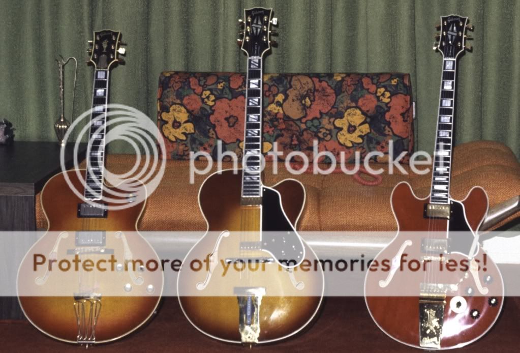

    And here we have three different pickup spacings, photo from 1971:
    Even with some squawk, the Byrdland was a beautiful guitar.
