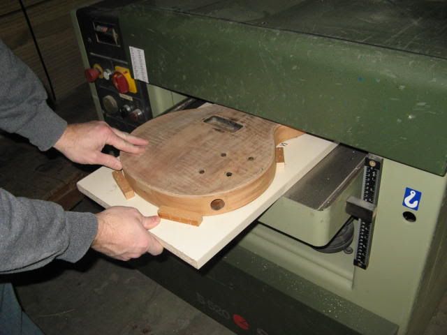

    I went into this project knowing I was going to do a retop. I know some of you think this will have a negative effect on the tone. IMOP the majority of tone is from the mahogany. The mahogany Gibson used in 1952 was some of the best tone woods. So off with the old top. First I'll run it thru a planer.
    And then finish it off with a drum sander.
