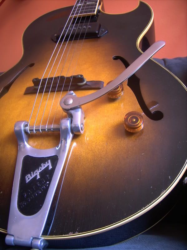

    Hello there!
    I have a 1952 Gibson ES-175 that I'm going to convert into an ES-175D (two P-90's). Who can give me some info on which toggle switch to use (long?), which 2 extra pots (short, 500K?) and which capacitor? Any help would be great!!! For the pickup I have a Seymour Duncan Antiquity Bridge P90 dogear in mind...
    And by the way, for all of you in Holland/Belgium/Germany, do you know anyone who I can trust in letting him (or her) do the job???
    [IMG][/IMG]

    Hello ES345,
    I don't know if the Bigsby is original, probably not. It looks old and has been on the guitar for a long time, but I haven't seen that many old ES-175's with a factory Bigsby. I still have the original tailpiece, but it's broke. So that might be the reason someone put a Bigsby on it someday...
    Because of all the reactions here I'm starting to doubt if I should go on with the conversion. I would absolutely die if something went wrong...

    The Bigsby looks almost certainly like a reissue to me. The castings are way too clean and (in the pics at least) it has little of the patina that an old Bigsby would have.
    I don't recall offhand when the first Bigsby tailpieces were available. The first Gretsch 6120 came out in '54, and it had a fixed arm Bigsby until '56.
    An original Bigsby will have holes drilled completely through the bar on which the string posts are mounted. The reissues are only partially tapped, with the string posts set into holes that don't go all the way through. There are some other smaller distinguishing characteristics, too, that more pics could resolve -- but I don't think there's much of a question.
    In any case, a lovely guitar. Personally, I think the bridge and middle positions really come to life with a Bigsby and an aluminum Bigsby bridge -- though that compromises the fat woody sound of the guitar as is. I have a '55 ES-175D, and I seldom use the bridge pickup alone. For that biting tone, I prefer a different guitar that's dialed in differently -- with a Bigsby and a different bridge.

    I'd take that home, no questions asked.

    I agree with the Professor - get a competent luthier to do the work and it'll turn out great if the pickups match.
    I would try and find a period P90, but the Antiquities are nice indeed.

    I'd take it to a luthier who builds archtops for a living - NOT your standard repair guy..
    Daniel Slaman and Richard Heeres in The Hague, Theo Scharpach in Limburg. Possibly there are more guys. Problem is they usually have a large workload and are not that interested in repairs, but they are the most qualified for the job.
    50s P90s are plentiful on Ebay.

    Does the guy who builds archtops for a living ever held or modified an original?
    Vintage and building new are two different things.
    I know a lot of builders who love to change frets, put in a new bridge, nut or tuners because it works better. Which is true. But not vintage.
    (I never dealt with the names you mentioned, I'm not implying that they don't know what they are doing. Just a question..... )

    Oh man, I'm looking at that P90 equipped Gold Top with all that mojo, and then I'm looking at that Strat/Kohler tailpiece, and then I'm looking at that Gold Top and then back at that tail piece, and man I'm crying.
    OK, 'nuff of that.
    if you're going to add the second pickup,I would recommend that you buy a pre-wired wiring harness from RS Guitarworks, with 500K matched super pots, and consider going to one of the pickup builders on Les Paul Forum for your bridge P90.
    Consider Zhangliquin or Lollar or Lindy Fralin.
    Too bad they didn't choose a B7 for that Bigsby.
    How about some more

    Well, you asked for some more pics so here they are!
    [IMG][/IMG]
    [IMG][/IMG]
    [IMG][/IMG]
    [IMG][/IMG]
    [IMG][/IMG]
    [IMG][/IMG]
    Concerning the last one: the original owner had 'T P' engraved in the pickguard, in pearl (Tom Petty? haha). I don't like it, so I applied a pinup-girl decal on it (don't know if I like that actually...), but most of the time I play it without the pickguard.
