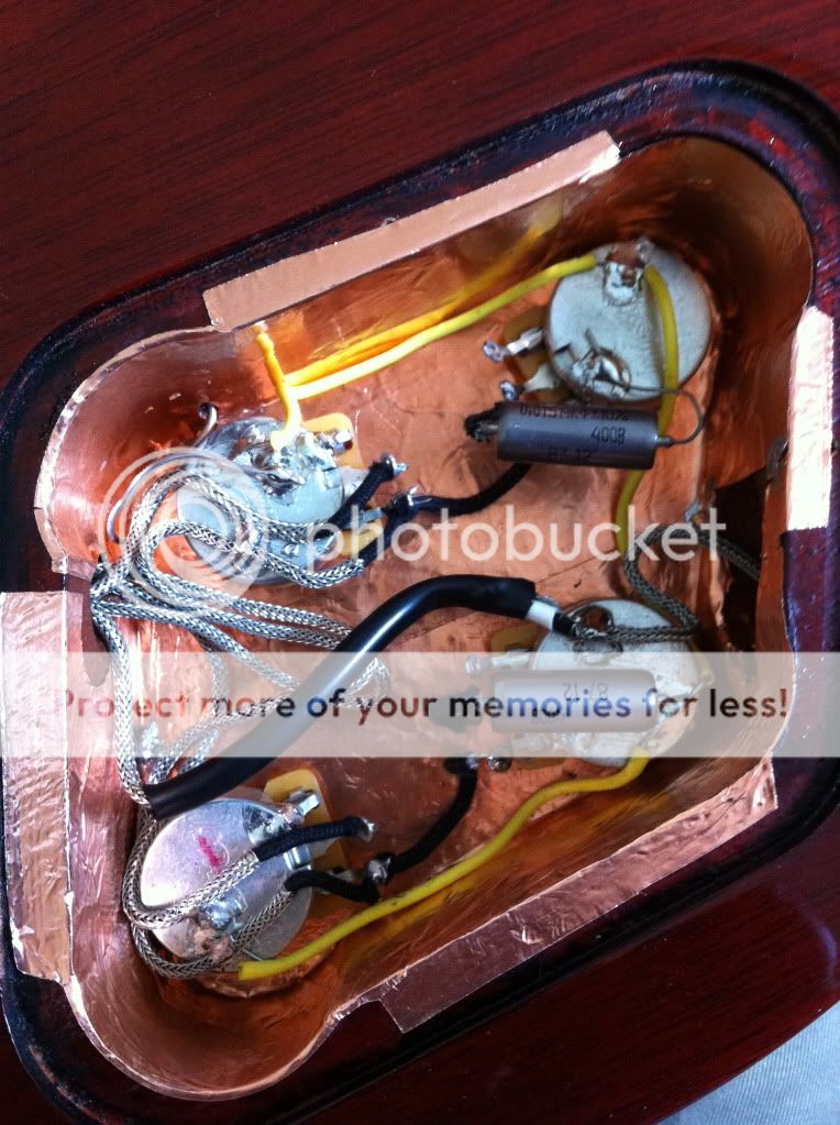

    I did a few things to tweak it up: Nickel Gibson ABR (no buzzing at all and tight tolerences), Nickel stop bar I had already, spiffier Gibson knobs, beveled the pickguard more to look more vintage, amber switch tip. The stock Kluson tuners were already nickel and the cream colored tulip keys appear identical to the Tonepros I have on another guitar. I also swapped the P-90 pickup plates to some nickel silver ones from Mojo. I do think they kicked the tone up a notch. I have NO desires to replace these stock P-90s, as they could not sound better to my ears. As witness, the bridge PUP sounds scary close to the original one in my vintage '61 LP Jr.
    BTW, I left the pots stock as they sound plenty bright and I measured one of the tone pots (I think it was a tone pot) and got close to 500K. Oh, I also shielded the control cavity and replaced the wiring to the switch with vintage style shielded wire. New Switchcraft switch and PIO caps as well. Hum is now very minimal, a definite improvement.
    I agree these are an incredible bargain.
